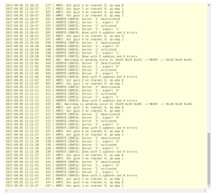

The debug log is repeating the following sequence over and over again.
2017-09-05 11:17:45    109 | GPS: 1PPS deviation too high 307330. Reset counter!
2017-09-05 11:17:45    109 | AMP2: Set gain 6 on channel 0, op-amp 0
2017-09-05 11:17:45    109 | AMP2: Set gain 5 on channel 0, op-amp 1
2017-09-05 11:17:46    110 | GPS: 1PPS deviation too high 267908. Reset counter!
2017-09-05 11:17:46    110 | GPS: Bad accuracy, resetting smoothing.
2017-09-05 11:17:47    111 | GPS: 1PPS deviation too high 249264. Reset counter!
2017-09-05 11:17:47    111 | GPS: 1PPS inaccurate! Counter is 44268950, should be around 84000000
2017-09-05 11:17:49    113 | EVENT: GPS 1PPS counter is accurate again.
2017-09-05 11:17:49    113 | GPS: 1PPS OK
2017-09-05 11:17:50    114 | GPS: 1PPS deviation too high 40448537. Reset counter!
2017-09-05 11:17:50    114 | GPS: 1PPS inaccurate! Counter is 43500712, should be around 84000000
2017-09-05 11:17:50    114 | REMOTE-CONFIG: Server '2' deactivated
2017-09-05 11:17:50    114 | REMOTE-CONFIG: Server '2', expert '0'
2017-09-05 11:17:50    114 | REMOTE-CONFIG: Server '2' activated
2017-09-05 11:17:50    114 | REMOTE-CONFIG: Server '2', expert '1'
2017-09-05 11:17:50    114 | REMOTE-CONFIG: Done with 5 updates and 0 errors
2017-09-05 11:17:52    116 | GPS: 1PPS OK
2017-09-05 11:17:55    119 | AMP2: Set gain 5 on channel 0, op-amp 0
2017-09-05 11:17:55    119 | AMP2: Set gain 3 on channel 0, op-amp 1
2017-09-05 11:18:00    122 | RTC: Setting RTC from GPS time, time difference was -2s
2017-09-05 11:18:06    128 | ADC: Watchdog is pending since 2s (0x25 0x24 0x24) -> RESET -> (0x24 0x24 0x24)
2017-09-05 11:18:06    128 | REMOTE-CONFIG: Server '2' deactivated
2017-09-05 11:18:06    128 | REMOTE-CONFIG: Server '2', expert '0'
2017-09-05 11:18:06    128 | REMOTE-CONFIG: Server '2' activated
2017-09-05 11:18:06    128 | REMOTE-CONFIG: Server '2', expert '1'
2017-09-05 11:18:06    128 | REMOTE-CONFIG: Done with 5 updates and 0 errors
2017-09-05 11:18:07    129 | ADC: Watchdog is pending since 3s (0x29 0x28 0x28) -> RESET -> (0x28 0x28 0x28)
2017-09-05 11:18:07    129 | AMP2: Set gain 5 on channel 0, op-amp 1
2017-09-05 11:18:08    130 | ADC: Watchdog is pending since 4s (0x25 0x24 0x24) -> RESET -> (0x24 0x24 0x24)
2017-09-05 11:18:12    134 | REMOTE-CONFIG: Server '2' deactivated
2017-09-05 11:18:12    134 | REMOTE-CONFIG: Server '2', expert '0'
2017-09-05 11:18:12    134 | REMOTE-CONFIG: Server '2' activated
2017-09-05 11:18:12    134 | REMOTE-CONFIG: Server '2', expert '1'
2017-09-05 11:18:12    134 | REMOTE-CONFIG: Done with 5 updates and 0 errors
2017-09-05 11:18:18    140 | AMP2: Set gain 6 on channel 0, op-amp 0
2017-09-05 11:18:18    140 | AMP2: Set gain 2 on channel 0, op-amp 1
2017-09-05 11:18:28    150 | AMP2: Set gain 5 on channel 0, op-amp 1
2017-09-05 11:18:39    161 | REMOTE-CONFIG: Server '2' deactivated
2017-09-05 11:18:39    161 | REMOTE-CONFIG: Server '2', expert '0'
2017-09-05 11:18:39    161 | REMOTE-CONFIG: Server '2' activated
2017-09-05 11:18:39    161 | REMOTE-CONFIG: Server '2', expert '1'
2017-09-05 11:18:39    161 | REMOTE-CONFIG: Done with 5 updates and 0 errors
2017-09-05 11:18:40    162 | AMP2: Set gain 5 on channel 0, op-amp 0
2017-09-05 11:18:40    162 | AMP2: Set gain 4 on channel 0, op-amp 1
2017-09-05 11:18:45    167 | REMOTE-CONFIG: Server '2' deactivated
2017-09-05 11:18:45    167 | REMOTE-CONFIG: Server '2', expert '0'
2017-09-05 11:18:45    167 | REMOTE-CONFIG: Server '2' activated
2017-09-05 11:18:45    167 | REMOTE-CONFIG: Server '2', expert '1'
2017-09-05 11:18:45    167 | REMOTE-CONFIG: Done with 5 updates and 0 errors
2017-09-05 11:18:50    172 | GPS: Receive OK
2017-09-05 11:18:50    172 | EVENT: GPS data check ok.
2017-09-05 11:18:50    172 | GPS: Everything OK
2017-09-05 11:18:51    173 | REMOTE-CONFIG: Server '2' deactivated
2017-09-05 11:18:51    173 | REMOTE-CONFIG: Server '2', expert '0'
2017-09-05 11:18:51    173 | REMOTE-CONFIG: Server '2' activated
2017-09-05 11:18:51    173 | REMOTE-CONFIG: Server '2', expert '1'
2017-09-05 11:18:51    173 | REMOTE-CONFIG: Done with 5 updates and 0 errors
2017-09-05 11:18:51    173 | AMP2: Set gain 3 on channel 0, op-amp 1
2017-09-05 11:18:57    179 | REMOTE-CONFIG: Server '2' deactivated
2017-09-05 11:18:57    179 | REMOTE-CONFIG: Server '2', expert '0'
2017-09-05 11:18:57    179 | REMOTE-CONFIG: Server '2' activated
2017-09-05 11:18:57    179 | REMOTE-CONFIG: Server '2', expert '1'
2017-09-05 11:18:57    179 | REMOTE-CONFIG: Done with 5 updates and 0 errors
2017-09-05 11:19:04    185 | REMOTE-CONFIG: Server '2' deactivated
2017-09-05 11:19:04    185 | REMOTE-CONFIG: Server '2', expert '0'
2017-09-05 11:19:04    185 | REMOTE-CONFIG: Server '2' activated
2017-09-05 11:19:04    185 | REMOTE-CONFIG: Server '2', expert '1'
2017-09-05 11:19:04    185 | REMOTE-CONFIG: Done with 5 updates and 0 errors
2017-09-05 11:19:06    187 | AMP2: Set gain 6 on channel 0, op-amp 0
2017-09-05 11:19:06    187 | AMP2: Set gain 5 on channel 0, op-amp 1
2017-09-05 11:19:14    195 | REMOTE-CONFIG: Server '2' deactivated
2017-09-05 11:19:14    195 | REMOTE-CONFIG: Server '2', expert '0'
2017-09-05 11:19:14    195 | REMOTE-CONFIG: Server '2' activated
2017-09-05 11:19:14    195 | REMOTE-CONFIG: Server '2', expert '1'
2017-09-05 11:19:14    195 | REMOTE-CONFIG: Done with 5 updates and 0 errors
2017-09-05 11:19:16    197 | AMP2: Set gain 5 on channel 0, op-amp 0
2017-09-05 11:19:16    197 | AMP2: Set gain 3 on channel 0, op-amp 1
2017-09-05 11:19:26    207 | AMP2: Set gain 6 on channel 0, op-amp 0
2017-09-05 11:19:26    207 | AMP2: Set gain 5 on channel 0, op-amp 1
2017-09-05 11:19:34    215 | ADC: Watchdog is pending since 2s (0x25 0x24 0x24) -> RESET -> (0x24 0x24 0x24)
2017-09-05 11:19:34    215 | REMOTE-CONFIG: Server '2' deactivated

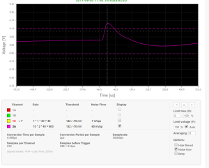

The signals, see:-
https://www.dropbox.com/s/ptqxgiuhulrxpm...8.png?dl=0
Again this seems to keep repeating this strange waveform and the numbers are just leaping about randomly.
I am now at a dead end, I don't know what else to do!
