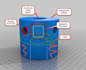

(2016-08-10, 12:11)bazzalight Wrote:
(2016-05-31, 21:30)RichoAnd Wrote: Richo,
I have started making the H field Copper tube Loop antenna shown in your mini guide and also from http://users.skynet.be/DanielV37/Project...m#Hardware.  I have produced 3D print files for the top & bottom Junctions from the drawings on that site and have published these files at http://www.thingiverse.com/thing:1713141 .  I have included attribution to the design as best I could find reference.  Can you have a quick look at this url and advise if any further attribution is needed.
thanks
Barry (Australia)
Have a lot of suggestions for changes - water intrusion is a challenge
By the way - time has run from this antenna - it is too large, and intended for System GREEN
Make it of brake tube 5-6 mm and a diameter of ~ 40cm
Most effective is the "Möbius" with transformer
