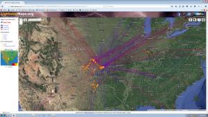

(2016-05-08, 13:25)Tobi Wrote: @Clément/Cutty: I don't understand the problem. Can you explain it please?
Well, here's a simple example from a few moments ago .. attached... Purple is bad, and too much 'previous' stroke persistence...
Attached Files Thumbnail(s)
Reply
Plus, all stations are shown (dots). Not only those which detected the strike.
Thus, it is not convenient for the mouseouver.
Clément
Stations: 733, 1440, 2601
