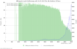

to 1Smile taking a look at http://wwlln.net/n showing the thunderstorms active on earth, you may notice that there is a lot of action within reach of the Canary Islands, especially towards the west and south. Attenuation over sea is low, so the sferics can be recorded well here. You should note the the station is also receiving sferics from the Americas and contributing to the location there. In South America and Africa there are simply not enough stations yet so many real signals the station here receives are not yet used by the network.
2.) I have no indication whatsoever of local noise sources. There simple is no "annoying interference" triggering the station, the signals are almost completely from sferics.
3.)There are no local sources of noise of relevance. The only one I have not really managed to trace concerns only the E field, hence the low amplification on this channel.
The bottom line is that I chose to run an "island station" aiming at coverage of the Atlantic around and from the figure below you can see that it works: up to a distance of 1000 km the efficiency is 100%, gradually dropping to 80% at 4000km. Then the American continent comes into play and the recognition rate drops.
You chose to run a station optimized for local recognition and that's what makes the difference.
A quality measure of an island station is the S/N ration, where N means real noise and not sferics from distant strokes, and of course the location accuracy. The efficiency and efficacy measure are of little value here.
Cutty has already proposed to make this distinction between isolated stations and integrated stations.

Pasense, That is exactly what I am saying, your station is not one of the less productive stations and seems to be within the better half of the graph.
The stations that my advice is mainly aimed at are the stations at the bottom right hand corner of the graph some of whom are sending tens or even hundreds of thousands of signals per hour and only recording very few strokes.
I am also part of the Region three network and report many strokes there as well, the graph that you chose to show is at the height of the lightning season here.
maybe you would compare that with today's graph, after all we don't wish to be accused of comparing Apples and Oranges.
You appear to have no local activity recorded at all?
Maybe there is not any lightning to ever be recorded in the sunny Canary Islands unlike in rainy Galicia?
Brian.  Smile

since I started the station here there was no thunderstorm on the Atlantic nearer than about 1000 km, and some scattered thunderstorms over North Africa, so there was simply no local lightning at all. This may change when we get lows from the west, with lightning and the sorely missed rains, but at the moment nothing like this is in the forecasts.
