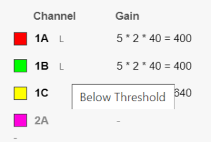

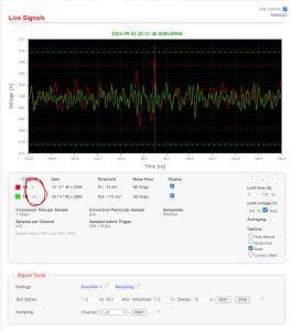

Can someone explain the A, LA characters adjacent to each channel and circled in red.
RE: Live signals A, LA. - dupreezd - 2024-09-02
L = Signal not sent. Signal is below the threshold you set for each channel. To be processed, a channel's threshold must be at least twice the channel noise level also.
P = Signal not sent. Signal is below threshold * adjustable_percentage.
A = Signal not sent.  You enabled Automatic filter by amplitude function, and the algorithms trigger the filter.
Best is to run full manual and not rely on the controller automatically adjusting the gain.
Hope this helps.
RE: Live signals A, LA. - gerbold - 2024-09-03
When you hoover with the mouse over the character (L in the screenshot), the meaning will be shown in a tooltip.
