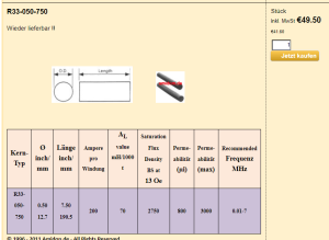

Mike,
Thanks for the explanation. Good thing i like tinkering with electronics/computers, lol
Indeed i am now tweaking in MANUAL mode. I've lowered the gains so background noise is between 20-30 mVpp. Trigger is 60 mV.
Seems to work well.
Currently i have just one antenna (coax loop), but planning two ferrite rods instead. I've been looking at amidon.de website and found the R33-050-750 rod. Is this the best one to get?
Thanks in advance!
