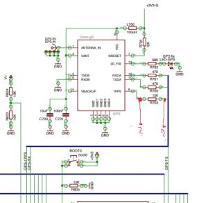

Weather muurame, your signal does not look right. It has a slow rise time and does not go all the way down to 0V. Ideally it should have a real sharp rise time. Check the voltage supplying the GPS chip. +3V3-G. It is generated by a dictated supply, IC505.
Regards.

I have tried it three diffrent gps module ( same model as it worked oroiginally), I am 99 % sure the problem is not in gps module.
As you see main fault is in pps signal, it rises too slowly. Next I have to chcek IC505 as dupreezed proposed.

I would also check the signal from 9 pins of the chip with no R703 resistor and the voltage at the points of the soldered resistor

(2019-06-03, 16:16)dupreezd Wrote: Weather muurame, your signal does not look right. It has a slow rise time and does not go all the way down to 0V. Ideally it should have a real sharp rise time. Check the voltage supplying the GPS chip. +3V3-G. It is generated by a dictated supply, IC505.
Regards.
