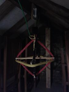

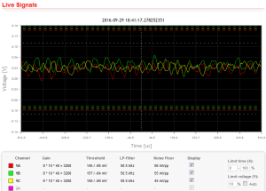

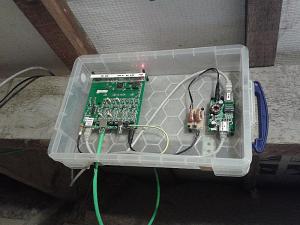

New Station Aerials and Noise Chasing - allsorts - 2016-09-29 The tale of my new blue station, roughly set up for testing, improving reception and reducing noise before installing. Only H-field at the moment as the E-Field is far too noisy placed inside the house. H-field aerials are 3 x 38 cm 20 turn (square) loops wound with 7 x 0.5 mm dia stranded mains conduit wire, approx 1.3 mm^2 cross sectional area. The three loops are currently coincident and arranged at 90 degrees to each other. Why three? Why not the system can handle three and I had enough wire, wood and hooks to make three. Also 20 turn loops don't need transformers and I don't have suitable toroids to make transformers. The stranded wire is just too big to fit into the terminal block on the H-field pre-amp board. So I used boot lace ferrules with the wire cores only half way down before crimping, leaving half the ferrule to be crimped small enough to fit the terminals. Reception doesn't appear to be much of a problem, the system is picking up signals from Tunisia around 2,500 km away and being used for locating strikes in Southern France. This is with the loops leaning against an internal stud wall inside a building with 18" thick exterior stone walls. The loops will eventually end up in a loft. E-field might be more of a challenge to get it far enough away from the house. -- Cheers Dave. RE: New Station Aerials and Noise Chasing - allsorts - 2016-10-03 Further noise chasing and reduction. My 38 cm 20 turn loops from 7 x 0.5 mm dia stranded copper wire have a sharp and very deep null. Careful alignment can reduce the the extremely strong MSF 60 kHz carrier from Anthorn into the noise floor. It's a bit sensitive though the slightest movement and MSF comes back above the floor. I also found that the 20 kHz signal also comes from Anthorn, so for one loop both of those are sorted. To aim the null of the loop accurately at Anthorn I connected an SSB communications receiver to one of the amplifier monitor ports. This receiver isn't supposed to go as low as 60 kHz but it does, it even goes down to 20 kHz but is beginning to get rather deaf by then. Using SSB makes the aiming dead easy just carefully rotate the loop until the whistle disappears. Another "aiming aid" that is probably easier for most people to obtain is a spectrum analyser app for their smart device. I have Android and used Advanced Spectrum Analyzer PRO from Vuche Labs. Connect the smart devices mic in to one of the monitor ports. The mic in is probably on the second ring of the Tip, Ring, Ring, Sleeve 3.5 mm plug of a smart device headphone set with microphone. There will be a small voltage on that second ring to power the headsets electret microphone. A blocking capacitor might be wise if this connection is likely to be used for anything else. The Blue amplifier monitor ports are buffered and have a capacitor so aren't worried by this low voltage/current supply. This app, and all other similar ones, are limited by the smart devices hardware to the audio band but this one will go up to 24 kHz. This showed me that the "20 kHz" carrier is actually 19.6 kHz and is 35 db above the noise on the loop looking at Anthorn. With the LP filter set to 16 kHz it's reduced to 10 dB above the noise. That's some sharp filter! It's not quite as easy to get the aim spot on but you can get pretty close. The app also showed a smaller carrier around 16.4 kHz, that's not the frequency I was expecting from Skelton and anyway the bearing is wrong. Further research into the source of that carrier required. Skelton seems very quiet and is 26 degrees away from Anthorn so should be easy to tell apart. The LP filters work very well, see above. For the loop looking at Anthorn I'll probably set the filter to 16 kHz to severely reduce the 19.6 kHz carrier. The other two set at 54 kHz to remove any residual 60 kHz signal but maintain as much bandwidth as possible to keep the rise time fast. On the loop with its null aimed at Anthorn I may try turning the filter off and see what Auto makes of that. With the 16/54 settings Auto sets the gain of the three channels the same (4000) to get the target 50 mV noise floor for each channel. In theory that means the loops will pickup fairly evenly from all directions. Awaiting arrival of a few bits to build a power supply filter to enable the use of a TP-Link TL-POE10R Power over Ethernet splitter and a box to mount everything in. Once those arrive the lot can be properly installed and I can think about where to put the E-field antenna. RE: New Station Aerials and Noise Chasing - RichoAnd - 2016-10-03 The filter attenuation is 57dB at 1.5 times f(CUTOFF),and 60dB at 2 times f(CUTOFF) My guess is -20dB at 19,6KHz with a 16KHz filter /Richo RE: New Station Aerials and Noise Chasing - allsorts - 2016-10-04 (2016-10-03, 17:45)RichoAnd Wrote: The filter attenuation is 57dB at 1.5 times f(CUTOFF),and 60dB at 2 times f(CUTOFF) 60 dB/octave pretty damn steep. I'm a broadcast sound engineer so understand filters in dB/octave. -20 is about what I saw bit difficult to get a really accurate reading as everything is bouncing around so a certain amount of "averaging by eye" was going on. The 16.4 kHz carrier and bearing match with JXN, Noviken, Norway, 1000 miles away. With there basically being no storms over Europe at the moment I'm pleased that I've got a low signal count, just over 100 for the last hour. That was in manual, switched to Auto and that has wound the gain up on a couple of channels giving them noise floors around 60 mV which I think is a bit high, the signal count has certainly gone up. These signals are very small only just hitting the default 120 mV threshold in auto, they don't quite make it in manual with the lower gain and noise floor nearer 50 mV. RE: New Station Aerials and Noise Chasing - allsorts - 2016-10-13 Installed ... Using a Frequency Analyser app on a tablet showed spot carriers on 16.4 Noviken, Norway; 18.3 Rosnay, France (moves about, also uses 21.7 and 22.6); 19.6 Anthorn, England; 22.1 Skelton, England. Noviken (1000 miles) and Rosnay (528 miles) are far enough away not to be a problem. Skelton (18 miles) must have been off a few days ago as you can't miss it now and it gives a nice beat pattern with Anthorn (38 miles). Anthorn is tremendous signal but can be almost eliminated on one loop by aiming its null in that direction. Unfortunately Skelton then comes in pretty strong. On the plus side they are only 27 degrees apart and the noise floor figures from the controller's web interface was the best way to find a compromise position. This loop is on Ch 1 and will have it's best pick up almost exactly N-S but only by chance it's alignment is dictated by Anthorn and Skelton... Of course the now E-W (Ch 2) loop gets fairly hefty doses of those stations. Setting the LP filter to around 17 kHz brings the noise floor down to that of the N-S loop at the expense of a lot of information above the cut-off frequency. The horizontal loop (Ch3) is less affected by Anthorn/Skelton but also doesn't pick up as many strikes as the two vertical loops. There is plenty of scope for more playing between "hard" LP filtering or "soft" LP filtering with or without equal gains. As can be seen the hard filtering does produce rather rounded and slow signals compared to the soft filtering. Then there is the E field... RE: New Station Aerials and Noise Chasing - DrRobin - 2016-10-16 Hi Dave, Did you find a good source for the LTE filter ICs? Looking at my signals, my main noise is at 20kHz and just over 60kHz. I see RS have a good price, but are out of stock. I found someone on Amazon for about £8, after that they are over £12. Robin RE: New Station Aerials and Noise Chasing - allsorts - 2016-10-16 I got my filter IC's from Farnell. Their website says they have 787 in stock @ £8.11 + VAT each (£9.73 inc). Go over £20 with an online order and you get free. UPS, next working day, delivery. Hope you have good eyesight they are flippin' tiny and not big enough for the "run a soldering along the pins" method. Fortunately they seem pretty robust, I missed soldering one complete edge of one of mine and it survived being powered. That 20 kHz will almost certainly be Anthorn on 19.6. The LP filter is incredibly sharp set at around 16 kHz it'll pretty much remove even my huge 19.6 signal but at the expense of rise time and all the information above the cut-off frequency. Spent the last couple of days re-engineering the aerials. Constructed another rotating mount, another single loop and a banana plug aerial patch panel. So I now have two vertical loops that can rotate independently. Ch1A has a loop with it's null aimed to get minimum signals from Anthorn/Skelton, meaning the lobes are more or less N/S. Ch1B has a loop set about 45 degrees clockwise from the first, so NW/SE. It still gets a fair amount of Anthorn/Skelton but less that being at 90 degrees. That's just how they landed, having drawn it out the second loop needs to go 135 deg clockwise to NE/SW. Ch1C has the horizontal loop. Letting it run for a while like this to see how it performs. Alll HP filters in, only one LP filter set: 19 kHz in Ch1B. PS. 4.5% cash back from Farnell via Quidco as well. RE: New Station Aerials and Noise Chasing - DrRobin - 2016-10-19 Thanks Dave, I saw Farnell had them so could have got them through work (we have an account). However, I found a seller on eBay who is about the same price, once the VAT is added, so ordered them from there. Soldering them in shouldn't be a problem, I have hand soldered QFPs before. I managed to get a spectrum plot of my interference, but posted it in another thread, https://forum.blitzortung.org/showthread.php?tid=1995 Post #16. The expected suspects are in there. Robin |
