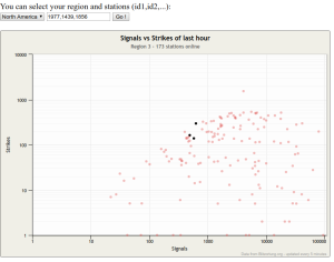

RE: Efficiency - readbueno - 2017-10-26 Hi Egon, Stations should maybe be weighted as to how useful the signals are that they send to the server? If there are only 20 stations that locate a stoke is that data more valuable than when 350 stations receive the same stroke? Is a stroke recorded at 200 km as useful as one at 1200 km or 4500 km? At present the effectivity of a station is heavily biased towards distance, Effectivity L. Would it be more efficient to base the stations position on their shorter and medium effectivity? Could there be some explainable scientific basis for these measures? Many stations appear to have a very poor signals sent to strokes recorded ratio. I have noticed this as over 75,000:1 in some cases, these stations still appear higher in the lists than stations with more even ratios. Should Detecting stations whose signals are actually used in the calculations for the location of the stroke be worth more than a station that detects the stroke, but is not one on which the calculation is based. Should stations in less densely populated parts, Blitzortung wise, get a premium for detecting strokes in relation to the area that they are trying to cover, i.e Coastal stations or stations that by their position cover mainly underpopulated areas? The Pacific Ocean area, Asia, Africa and South America spring to mind and Micha's new station for India? Looking at the archived data for stations participating in the detection of a stroke, there seems to be a large variability in the quality of the signals sent, not only between greens, reds, and blues, but even between stations of the same groups. Should there be some measure of the "quality of signal" sent to the server? Signal to noise ratios? Index of Distortion? I am sure that others may have better ideas, I shall sleep on this and maybe add more tomorrow. Kindest regards, Brian.

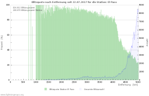

My comments are: For 1.): assuming the station doesn't have internal noise (suitable power supply, shielded/ unshielded cables, well placed antennas) only external noise counts. If you cannot identify and eliminate noise sources, there are only two options: if the frequency of the noise sources is higher than say 15 kHz use the LP filters and set the cutoff frequency accordingly; if not, lower the amplification and/ or raise the threshold. For 2.) Egons suggestions are good, but what about a quality measure for the signal used in calculations? For stations within the network (but ONLY for them), this appears to be a good indicator: https://www.meteomelin.be/staticfiles/bl...egion=1&id= In the case of the few stations contributing to more than one region the regions should be combined in the efficieny measure, but if the regions are going to disappear anyway, this may not be required. For 3.) Stations within the network (surrounded on all sides by other stations within a reasonable distance) need to be treated differently from stations at the fringe of the network like coastal stations or even completely isolated stations (on islands, isolated towns...) Maybe one could calculate a measure that indicates the integration or isolation of a station? From the experiency of the other network that operates globaly (http://wwlln.net/) I would suggest to install the LN filters directly on the board since soldering the tiny ICs afterwards is really difficult. Wwlln uses a cutoff of 22 kHz since most of the sferic signal strength is below this frequency. If bought in quantity the cost of the LP filters is acceptable and the added flexibility in handling noise and improving S/N ratio is well worth it. RE: Efficiency - readbueno - 2017-10-27 Hi All, We need to define what we each mean by "efficiency" and agree on a common definition? In the case of:- https://www.meteomelin.be/staticfiles/bl...egion=1&id= Would it be possible to develop this tool slightly more and have an average accumulated total for various longer periods, updating every five minutes and only giving the results for the last hour, whilst very useful, does not go far enough. One day, One week, One month? This need not be "real-time" for the historic data and would show the affects over time, especially if several graphs could be seen on the same screen at the same time for comparison. This "pattern" might also help with the station stats pages, i.e. more variable periods of time rather than just the last 24 hours, or the total stored data since the station started. This would help in "optimising" our stations and reduce the overall load on the servers. A better explanation of how the auto functions work, some basic instructions and improving their working, would make it easier for people who do not have a lot of time to fully monitor and manage their stations? Information and education should be part of running a station, if we don't know what we are doing, or what the overall aim of the network is, then different stations are going to have different goals and this will lead to less network efficiency. Maybe the LP filters could also be managed by the server to allow for wider bandwidth at times of low noise? I know that I have maybe drifted off the main topic of "Efficiency," but surely these and some of the other suggestions made in these recent posts are inter-related. Brian.

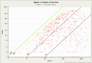

RE: Efficiency - Breitling - 2017-10-28 (2017-10-27, 09:15)readbueno Wrote: Hi All, We need to define what we each mean by "efficiency" and agree on a common definition? Nice graph. I would add some reference lines for a better interpretation: RE: Efficiency - readbueno - 2017-10-28 Hi Luis, Yes I like that Idea. No-one is going to get near 100%. As we see, most stations are between your yellow and the black lines, that seems to be the "reasonable" area, although that should not discount stations in that area trying to improve! The area to the right of the black line should be an indication that these stations are not working as well as they should/could, and that an effort should be made to improve this situation. The nearer you get to the bottom right hand corner the more opportunities for improvement are open to you? These stations are your Blitzortung neighbours, you should help, them just as you do your physical neighbours, when they need help. Maybe the actual points could be made different colours to show the "health status" of the stations? Brian.
