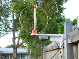

Richo,
thanks for your earlier advice. I have just commissioned by System Blue (ID=1631) and as per your suggestion I have built a paired 38cm diam Copper Pipe loop (6mm air condition tube) with 50 turn Toroid Ferrite Transformer.  After a false start with the ethernet wiring and then playing with the gain and thresholds I think it is performing quite well (noise floor about 19mV & effective detection ratios compare well to other stations in the area).  I didn't worry about O ring seals at this point I will use silicon sealant later to keep moisture out (but it won't stop the ants !!)
For others wanting 3d print the top & bottom brackets (or to look at more pics to seed their own designs) I have put them at http://www.thingiverse.com/thing:1792866
regards
Barry
