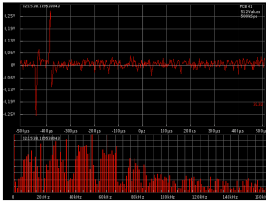

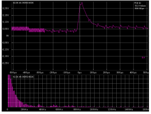

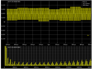

O.K. I have switched back to version 8.2 but the status on the map page still says 8.3b. so there still seems to be a fault with the communication.
I was only running for a short while, but, as you can see, very little has changed.
It does seem that the E channel is not going negative and the other two are just generating garbage interference.
I will have a another go at it tomorrow. Huh
Brian.
