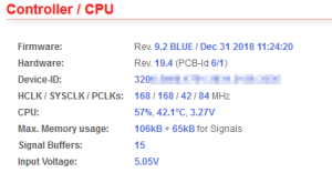

Did you plug your controller Device-ID number, (Connect to your controller and scroll to Controller/CPU)
into the Processor-ID field of your BO profile? Just the numbers, no dashes (-).
