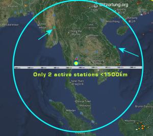

I’ve spent the last couple weeks in Thailand, particularly Pattaya area And there seems to be a huge hole in detection over the Gulf of Thailand. Sitting on the beach looking west almost nightly, you can see cloud to cloud lightning Which could be very far because there is no sound But on the map, even 500 miles away there are no hits. Furthermore, almost daily there is cloud to ground strikes with no hit.

(2025-09-16, 11:55)NRDcubed Wrote: I’ve spent the last couple weeks in Thailand, particularly Pattaya area. And there seems to be a huge hole in detection over the Gulf of Thailand. Sitting on the beach looking west almost nightly, you can see cloud to cloud lightning Which could be very far because there is no sound But on the map, even 500 miles away there are no hits. Furthermore, almost daily there is cloud to ground strikes with no hit.
Yes you are right. I looked at https://map.blitzortung.org/#5/9.21/104.38 to see where there are active Blitzortung stations. All of the stations that immediately surround the Gulf are presently "offline". The way you can tell this is to look at the curved brackets that surround the colored dot of the station. The eleven or so stations that immediately surround the Gulf all have curved brackets that are gray.
- There have been five stations in Thailand and all are presently offline.
- There have been two stations in Cambodia and all are presently offline.
- There has been one station in southern Vietnam and it is presently offline.
- There has been one station in southern Myanmar and it is presently offline.
- There have been three stations in nearby parts of Malaysia and all are presently offline.
It would of course be most welcome if some of those stations could be returned to online status. This could help with the hole in detection that you describe.
Every now and then, a lightning strike in the Gulf of Thailand will get detected using signals from other Blitzortung stations that are much further away. For example just a few hours ago this strike was detected: 2025-09-16 20:39:17.239059456 .
With the help of forum member Robo I was able to learn more about how the Blitzortung system detected and localized that particular strike. One Blitzortung station that helped to find that strike was the sole active station in Vietnam (2243). Another that helped was in the Philippines (2710). Eighteen stations in Japan helped to locate the strike. And a station in Omsk, Russia (2769) helped -- that station was about 1700 km away from the strike.
This strike that I happened to notice on the map was, I suspect, a rarity for the location. I bet there are lots of strikes in the Gulf of Thailand that don't get detected.

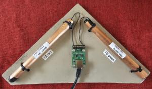

(2025-09-18, 16:35)oppedahl Wrote: I see that for each of these four stations, you chose ferrite-rod antennas. I think that is smart. For the host with what might be limited experience, any other kind of H antenna has more ways it might go wrong.
Do you add shielding to the FRAs?
Do you mount the FRAs and preamp to a board, so reduce the risk the host will damage the fine wires from the FRAs?
Hello,
I started with loops but the ferrite are definitely easier to package and 'tune'. With a 15m cable, I only instruct the host to place it anywhere away from any obvious source of noise and watch with the "FFT html page" provided by Mike. Sometime on the ground below the bed, sometime on top of a wardrobe, etc... Not optimal for sure but again, my host are not engineer and I try not to bother them more than a few days
I have not shielded the ferrite rod, only using shielded cable between the detector and pre-amp. My antenna packaging was discussed at: Thread 3983. Since then I have read post that indicate 'L' is better than 'X', but too late (and it works).

Thank you for your posting, and again, thank you for your work that helps the goals of the project by providing a chance to get some stations working in a part of the world that previously did not have much coverage.
I see that you labeled the "ANT" port on the processor box. That was smart. It reduced the risk that your host might inadvertently plug the wrong cable into the wrong port.
I admire your antenna packaging. It looks like you found some black plastic box that was very lucky in its size and shape, that you were able to repurpose as a way to secure the two ferrites and the preamp. You end up with a very nice looking box that is easy to ship and you do not need to worry about the host possibly damaging the thin wires from the ferrites. It looks like the box has two keyhole slots on the back for wall mounting. But I cannot guess where the plastic box came from. Can you share how you happened upon this box with its ideal size and shape?
