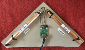

I see that for each of these four stations, you chose ferrite-rod antennas. I think that is smart. For the host with what might be limited experience, any other kind of H antenna has more ways it might go wrong.
Do you add shielding to the FRAs?
Do you mount the FRAs and preamp to a board, so reduce the risk the host will damage the fine wires from the FRAs?
