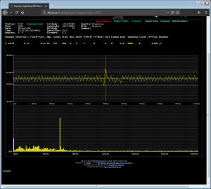

good afternoon, I can not see the data on the map, the station is all green but does not take the rays, and we are under a storm, I need help please thanks!
station 2347

Yes, there seems to be, at the moment, some issue with display on Regions 3 and 5... I suspect some work is being done...
Welcome Aboard!
2347 is set to report to two Regions, currently, North and South America, so you';re listed two times on the station list...
You also have a strong noise source at about 63kHz which triggers on your H C channe (Yellow)l, and sometimes on E (Magenta)...(if your antennas are configured normally, on your Operators Page')... you might want to check your antenna location, or nearby sources...  you might be able to eas that a bit...  (attached)

Thank you very much for responding! There is no way to connect and see that data on another map, no?
